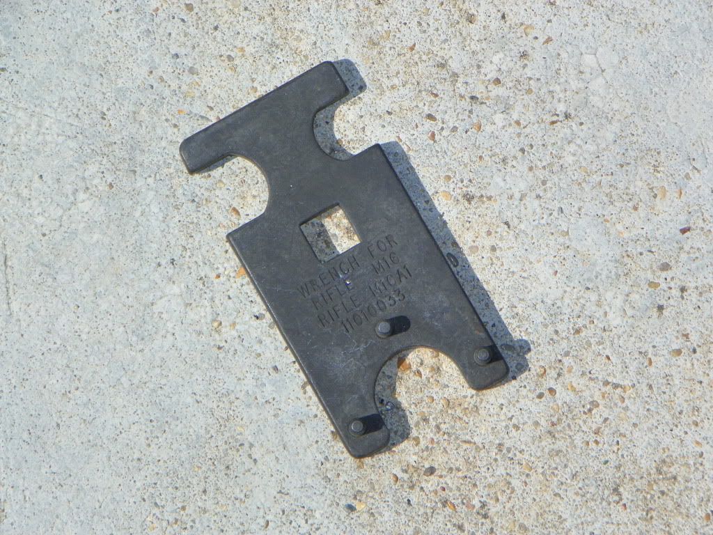

Bushmaster. I also have one of these, but it's just for display with my M16A1 clone:

So can I just remove the M4 foreend and bolt this one on without an armorers wrench?
The XV comes with standard hand guards, correct? If so, and you want the OnegaX rail (not the Onega you just pictured) you will need use the portion of the wrench with many teeth. The rail you had initially asked about is the OmegaX. The rail you just pictured is the Omega. They are quite different in the way they attach. The OmegaX rail uses a proprietary barrel nut. In fact, very, very recently I have seen it come with a new style nut. No armorers wrench I have seen comes with a tool to tighten it. You will need the wrench DD makes to tighten the OmegaX barrel nut (and a ratchet wrench to attach it to). You will also need a flat head screw driver, a Allen key to tighten the screws on the rail (although I believe DD includes one) a hammer and punch to remove the taper pins from your front sight, and a wrench to remove your flash suppressor (most armorers wrenches have a cut out for this. A vice and receiver block are also required.
Damn, DD needs to come up with some new product names.
But then again I'm not too well versed in their offerings.
The one I bought (From the EE) was listed as DD Omega X 12.0 fsp.
How does this unit mount?
Will it do away with the black cone shaped thing between the upper receiver and the standard hand guard?
I was previously typing from my phone in the waiting room of the car place. Wow, sorry for so many typos. The OmegaX12.0 FSP is a great rail, its light weight and will go great on the gun you have. Step by step you will have to:
1: remove your standard hand guards (no tools necessary)
2: punch out the taper pins in your front sight, it is important you push them from the bolt catch side of your upper out to the ejection port side of your upper (left to right). They will not come out the other way. (you need a standard hammer and punch, a taper pin starter is not required but can be VERY helpful.
3: put your upper in a receiver block, put your receiver block in a vice. Remove your muzzle device and front sight (there is no need to remove the gas tube from the front sight/gas block).
4: remove the stock delta ring assembly using any one of the barrel nut tools described in this thread. They will all work
5: take the barrel nut that will come with your rail and slide it over the barrel on to the threads of your upper receiver. There will probably already be grease on the threads, it should be sufficient to use it without needing to reapply more. (if I am mistaken, someone please correct me). Tighten it as far as you can to be hand tight.
6: using the DD OmegaX barrel nut tool attached to a wrench, tighten then loosen the nut 3 times to about 30-35 ft pounds (I have heard some people say you don't have to do this three times, I have heard some people say you must. I do it to err on the side of safety).
7: finally, torque the barrel nut on between 35-80 ft lbs, I know, that's a big difference between min and max, but the OmegaX does not have to be timed like many many other barrel nuts. I usually like to try and tighten to the higher end if possible.
8: put your front sight/gasblock/gas tube through the area of the top rail of the OmegaX and slide your front sight onto the barrel, make sure the gas tube goes through the hole in the upper. You will see how the rear of the rail fits in the space between the upper and the barrel nut you just installed. leave it loose for the moment. Reinstall your muzzle device while it is still in the vice. remember, there is a wide end and a narrow end to the crush washer that is likely on your upper right now. The narrow end goes against the barrel, the muzzle device goes against wide end.
9: take the upper out of the vice and install the lower rail, fitting it in that same gap between the upper and the barrel nut, then install the flat head screws to attach the upper and lower rail.
10: to align the top rail with your upper receiver, I like to take and old removable carry handle and put it between the upper and the rail. I have seen people use old TA51 ACOG mounts and other things, but honestly, there is no mention of using these things in the directions, which leads me to believe you can just eyeball it. Still, I like using something to help in the alignment. At this point, take the small allen key that will come with your rail and tighten the small screws towards the read of the rail. I do not recall, offhand, if there is an order DD suggests they be tightened. If they do (and I think they do) it will say so in the directions. You do not have to over-tighten these small screws. Make them tight enough to be snug, that's it.
You should be done at this point. Have fun. Go build another gun so you can reuse any of the tools you may have had to purchase. PS, the tools I linked you to are just to give you an idea of what you might need or could use. I'm not suggesting any one specific brand or model.

RaisedByWolves  [Member]
8/16/2011 7:11:16 AM
Snipped to clean things up a bit.
Thank you, just what I was lookin for.
I could easily figure things out once I had all the parts in hand and even make the DD wrench (Toolmaker). But I want to order all the required wrenches today so I can take this to the range this weekend and try it out when sighting in my Benchrest gun.
Many thanks.
BTW, Ill probably carve up some Nylon to hold the upper.
Thanks for the suggestion T-Merc.
new-arguy  [Site Staff]
8/16/2011 7:29:22 AM
You probably would have caught this, but I realize now that I did not mention reinstalling the taper pins in the front sight/gas block. That can be done at the very end, there are cut outs in the rail specifically for this task. Remember, the pins will only fit in one way. Give them a c few hard smacks with a large punch and hammer until they are fully seated.
