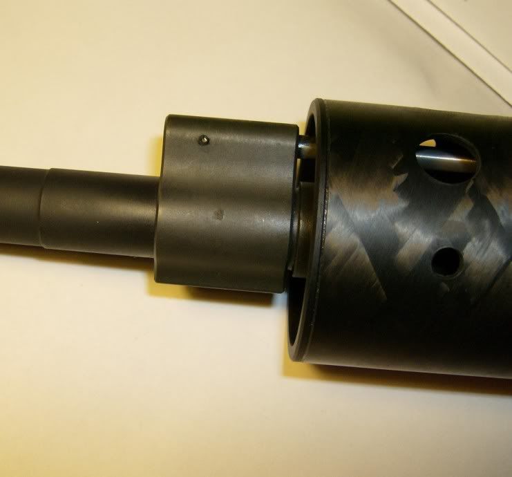

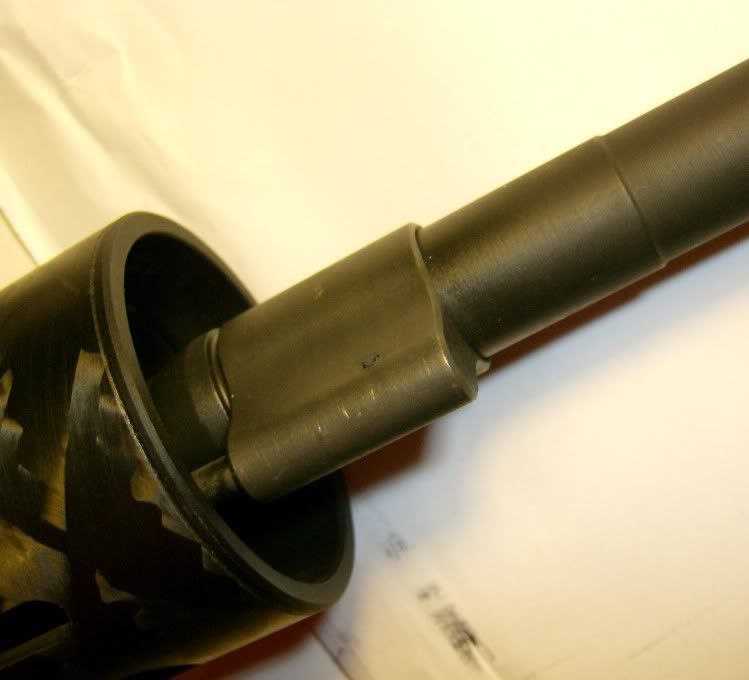

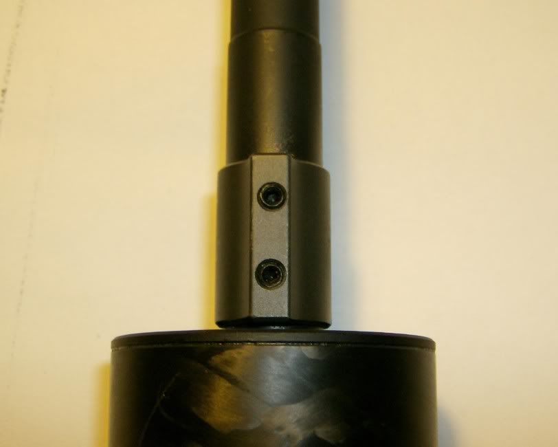

That's a different situation than that of dealing with an FSB. Below are some shots of a CMMG Micro gas block:
As you can see, there are two pins securing it on the bottom, and they're not going to tap out as would FSB pins. They don't look like screws or hex nuts, but then it's 1:50 in the morning and these eyes are usually snoozin' at this time. Frankly I'm not sure how to go about removing said block. I think I'll just leave that one right where it is.
If you're waiting on an upper that you've already ordered from CMMG, you'll probably be best advised to just call them and explain what you'll be wanting to do. They've accomodated me in the past. As someone noted above, you can cut the cap off as a last resort.
ORinTX  [Team Member]
5/17/2008 2:51:27 AM
Those look like countersunk hex head set screws to me. Not that my vision is super awesome either.
MMcfpd  [Life Member]
5/17/2008 2:54:47 AM
OK, I powered up the right eyeball to full and discovered that they are in fact 5/64" hex nuts. Ought to be a little easier to remove than an FSB.

Eric__Oh  [Member]
5/17/2008 3:14:11 AM
Thanks for the helpful pics and replies fellas!
Seems it'll be easier than expected, i'll just knock out the roll pin with a punch, and use an allen key to remove the two screws to get the gas block off and then slide the end cap off. Seems pretty straight forward. Thanks.
5/17/2008 3:22:04 AM
That'll pretty much do it. You may have to pull the gas tube out when you go to swap the rail, but once you pop the aforementioned roll pin and pull the gas block off, there's nothing retaining the gas tube so it doesn't add to the complexity any.
