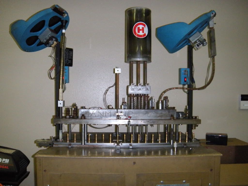

1968  [Member]
7/10/2010 5:37:44 AM EST
Last time I checked on an ammoload, they were $17,000 for the machine and another $5,000 for the bullet and brass collators and that was for the pistol machines. I also have a manmatic .223 machine that ammoload just started reproducing and those are about $50,000.
unclemoak  [Team Member]
7/10/2010 5:53:25 AM EST
http://i775.photobucket.com/albums/yy31/RandRAmmo/DSCN0320.jpg
http://i775.photobucket.com/albums/yy31/RandRAmmo/DSCN0312.jpg
If you don't mind my asking, are those for personal use or do you have an ammo business?
1968  [Member]
7/10/2010 6:11:33 AM EST
I have an ammo business.
